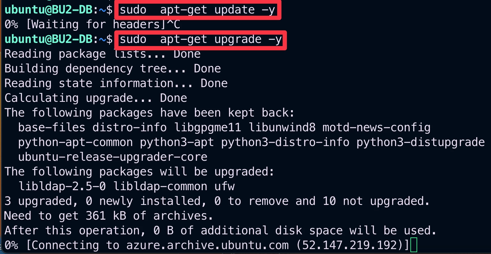

SSH to the BU2 DB (this VM does not have a Public IP, whereby you need to SSH to BU1 Frontend first, and then from that VM, issue the SSH command towards the Private IP of BU2 DB) and verify whether the apt-get commands are working or not.
HINT: In addition to the apt-get commands, carry out the following commands:
- curl https://www.google.com
- curl https://www.wikipedia.com
- curl https://www.espn.com

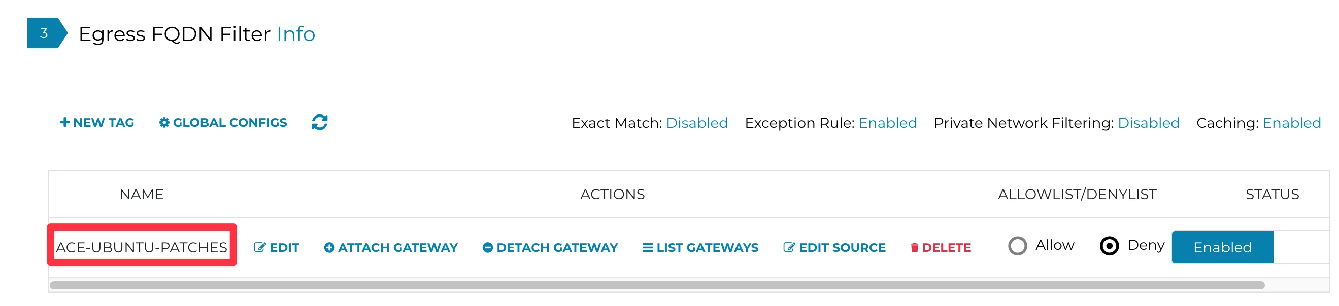

- Check the FQDN Stats
HINT: Go to Controller > Security > FQDN Stats > Gateway FQDN Stats and set the Time range to “Today”.
Verify the configuration of the Egress FQDN Filtering Policy.
HINT: Go to Controller > SECURITY > Egress Control > Egress FQDN Filter and then check the policy called “ACE-UBUNTU-PATCHES”.
Is there something suspicious in the configuration of the policy? Try to fix the evident misconfiguration!

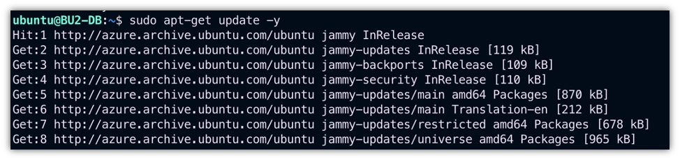

Relaunch the apt-get commands after applied the resolution.
