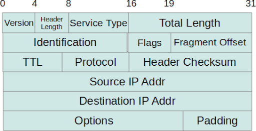

In the image below, an IP header is shown in detail and gives you an idea of the kinds of things a firewall can see for a given piece of traffic.
