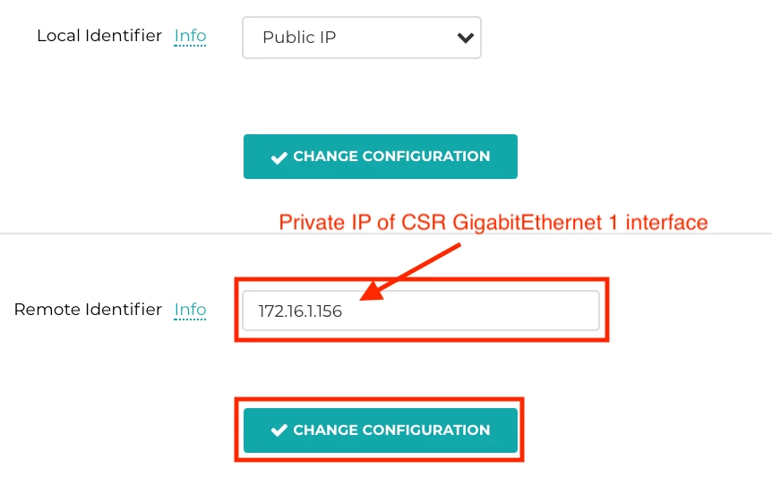

When you're creating an IPsec tunnel using the Strongswan IPsec implementation, you need to specify a Remote Identifier, which is the WAN IP of the CSR.
However, the Cisco CSR does not act as a true branch router in that it is actually being NAT'd by an AWS IGW. For that purpose, when you are building an IPsec tunnel using IKEv1, you need to specify that the Remote Identifier of the IKE tunnel is actually the private IP of the CSR, not the public IP that the IGW gives it.

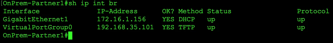

To find out the Private IP of the CSR, one way to find out is to log in to the AWS Console (assuming you have access). Another way is to SSH to the router and issue the IOS command show ip interface brief, such as this:
Then you would take the IP address specified by GigabitEthernet1, and use that as the Remote Identifier when configuring the Site2Cloud connection on the Aviatrix Controller.
