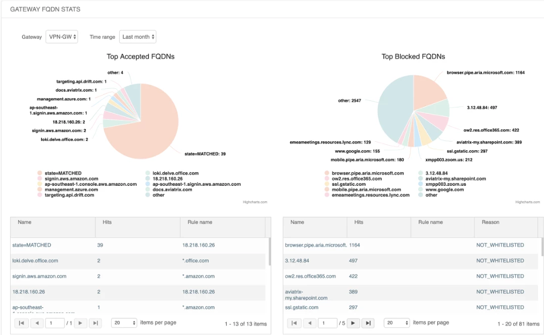

Finally, audit logs provide the perfect way to audit your PCI compliance. Being able to prove, once you are in an audit, that you are compliant is as important as having the actual compliance framework in place. With Aviatrix, audit logs showing what traffic is allowed and what traffic is denied, makes this task easy. Here is one, high-level example of what domains are being accessed by a specific VPC:

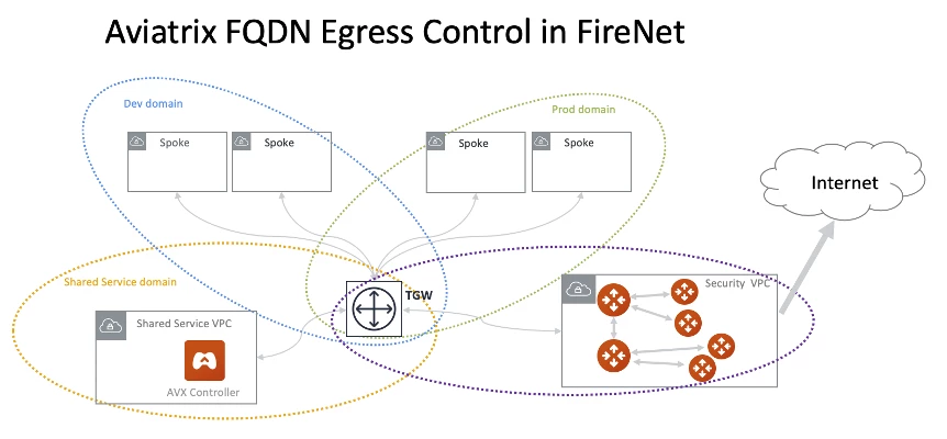

Aviatrix VPC Egress traffic filtering is designed to address this requirement.
Aviatrix Egress Security Filter

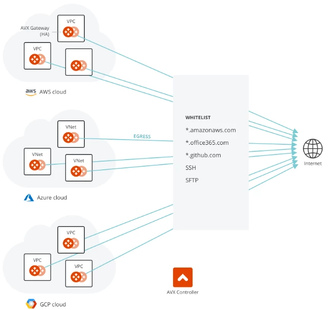

In addition to IP-based policies, Aviatrix gateways can perform egress traffic filtering. This feature allows outbound internet traffic to be filtered using full or wildcard-based host names.
You can do this in a distributed fashion from each VPC/VNet
You can do this in a centralized fashion from each VPC/VNet
For example, update sites, such as updates.ubuntu.com and windowsupdate.microsoft.com, can be resolved to many IP addresses so these policies can be configured using their domain names. Other hosts, like services provided by AWS, might be allowed more broadly by specifying a policy which includes a wildcard (for example *.amazonaws.com).

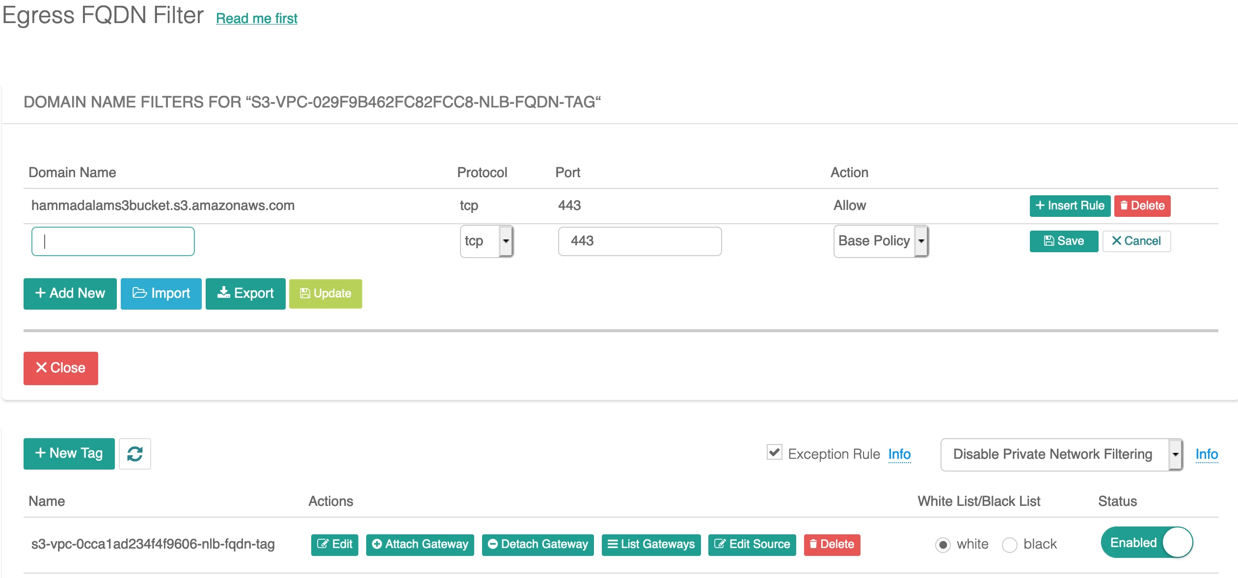

Autodiscover Hosts that Require Access
In many cases your engineers may not know or remember all the external hosts that need to access the internet. For this reason, Aviatrix provides an auto-discovery feature on our gateways. With this feature enabled, the gateway operates in "learning" mode, watching and recording all outbound traffic. At any time during this mode, you can look at what hosts are being accessed and develop your policy from this list with input additional from your engineers.

Audit Logs
Allowed and/or denied destination IPs and domain names are logged and can be viewed in logging services such as Splunk, Sumo Logic, etc.
